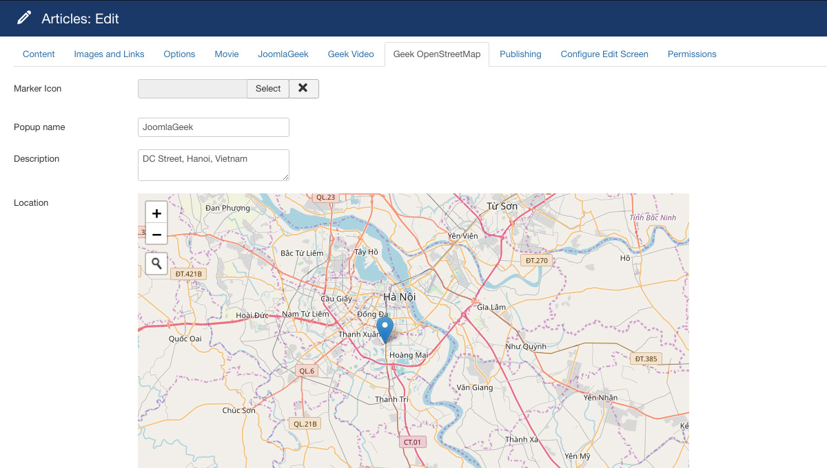

Add Geolocation data to Articles
Articles containing geolocation data will be displayed on the map module if you select “Articles” as the data source.
You can further refine the list of articles displayed on the map module by selecting filters under the “Articles Filtering Options” tab of the module settings panel..
Data Addition:
- Go to Content > Articles
- click the New toolbar button / or edit existing articles
- On Edit Article screen, you will the new tab named Geek OpenStreetMap
- (1) Use the Location field to set coordinates (latitude and longitude) which are used to display article on maps.
- (2) You can also add GeoJSON data to represent the points (therefore addresses and locations), line strings (therefore streets, highways and boundaries), polygons (countries, provinces, tracts of land), and multi-part collections of these types.
- NOTE: Utilizing the online GeoJSON editors, you can create shapes (lines, polygons) and subsequently copy the generated data (in JSON format) into the GeoJSON data field.
- Choose Save & Close button

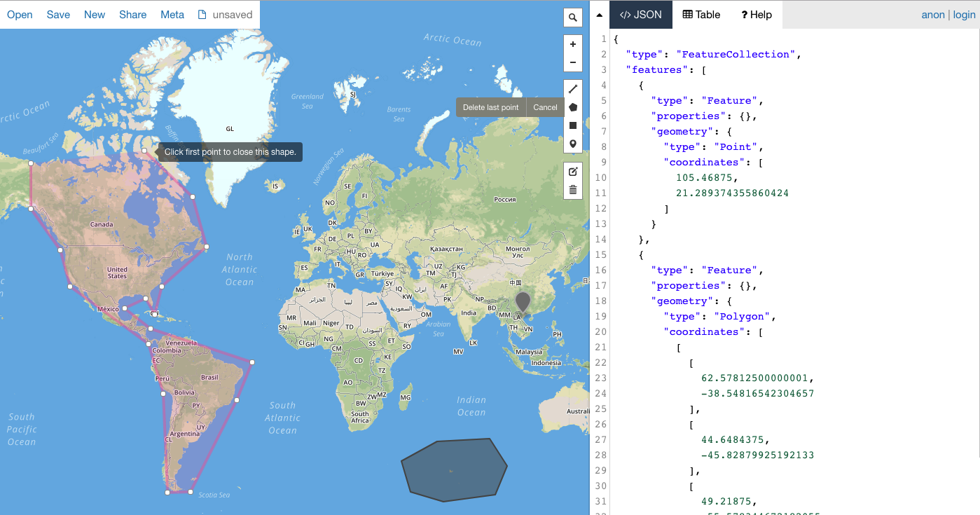

Create GeoJSON files
Geek OpenStreetMap module supports to load data from GeoJSON format files. GeoJSON is an open standard format designed for representing simple geographical features, it supports the following geometry types: Point, LineString, Polygon, MultiPoint, MultiLineString, and MultiPolygon.
There are many online editor tools that enable you to draw shapes (lines, polygons) and add markers on a map with visualisation tool, then download map data as GeoJSON format files. Below is a list of some online GeoJSON editor website:
After creating and downloading GeoJSON files, you need to upload these files to the data folder of the module:
modules/mod_geekopenstreetmap/data/
Once done, you can select a file to display on your map from the settings panel of the module.
